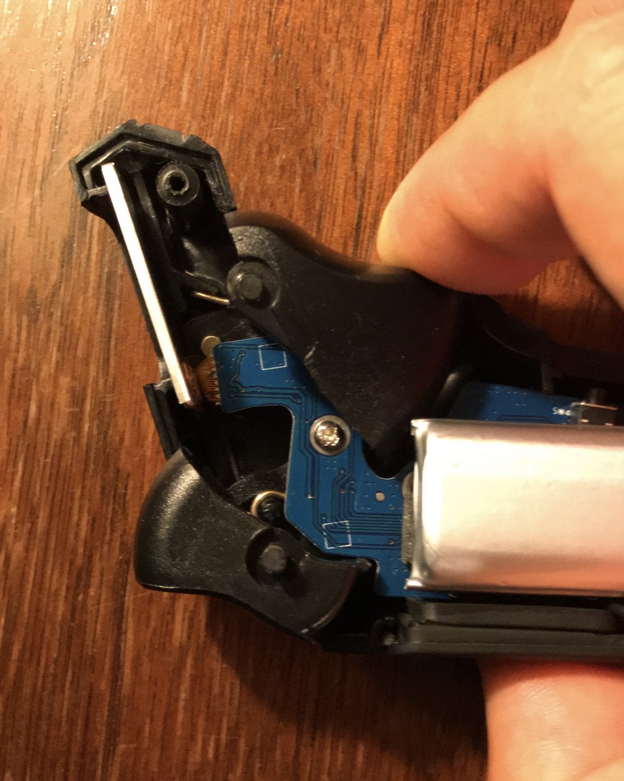

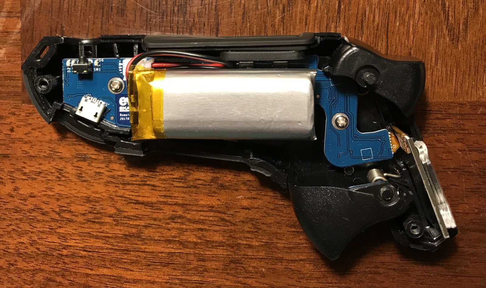

    EC24606A-DE8A-41CB-950D-B819EC0E7880.jpeg 9AD922D9-1256-4A66-B066-46283667FCAC.jpeg 70523D80-AF73-4107-A2B3-E7CC196B06F3.jpeg 5DBB2609-DA66-4EBB-9416-17AA4B07BA07.jpeg Solderless, plug ‘n’ play battery upgrade for the R2 remote. Available on Amazon for $7 with Prime, 2-day shipping.

    I haven’t tried to tamper with my R2 remote at all yet. Does it just pull apart and snap back together easily? Always interested in upgrades but hesitant because I don’t want to accidentally break anything!
    walterafable
    walterafable Member
    Super easy. The remote is held together with two screws. Note that the plastic cover over the screen, the deadman switch, and the power button are not attached so they will come loose, but they’re easily put back in place as you screw the remote back together. Use needle nose pliers to unplug the existing battery. Pop in the new one - no soldering needed if you use one similar to the one I linked. Check that the trigger can go through the full arc of motion and screw it all back together. Voila.

    The 1000 mAh battery is a snug fit. I don't think anything larger would fit without modifying the remote housing.

    In this instance, I replaced the older, smaller (500 mAh) battery previously provided by Evolve. The one that they provide now is a 750 mAh battery. I have a second R2 remote with the 750 in it - i'm going to replace that too with the 1000 mAh battery pictured above.

    No. There’s enough room for the deadman switch. Not sure why you’d have to remove it.
