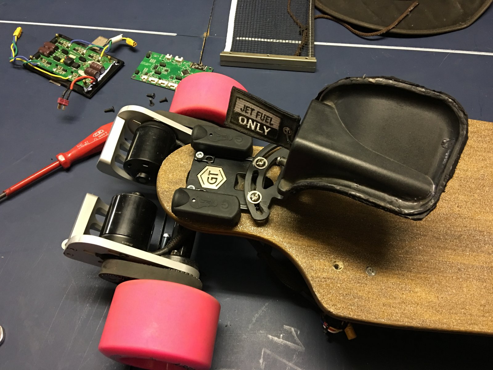

    I have started using a rear freeboard binding and really like it, It makes you feel like i'm one with the board and the board is with me ;p
    [​IMG]

  3. bgudell
    bgudell Member
    How did you mount them to your board. I just ordered the Freeboard S2 bindings. Im planning on mounting them to the inside truck screws.
    Have you rode them off road?
  4. Nickelberry
    Nickelberry Member
    Yeah I used the inside bolts, it works really well, especially off road.

  5. bgudell
    bgudell Member
    Very nice. I'm also gonna mount my shred lights the same way.
  6. Rockinjohn
    Rockinjohn Member
    I actually mounted both just outside of the battery compartment since I prefer riding with AT setup ( street was too slippery for my hard carving style). I felt that by mounting them on the trucks the AT wheels wouldn't have enough clearance from my shoes.

  7. bgudell
    bgudell Member
    Ahhhh. I was nervous about that. Nickelberry, does your shoe ever hit wheel or na? It looks close for AT.
  8. Rockinjohn
    Rockinjohn Member
    Actually after several friends complained about them I mounted a SUP traction deck on the whole board (awesome feel and traction) and removed the rear binding. With the front snug fit of the binding and the loose rear kick pad I love this combo. You can really lean into the S-turns at high speeds with confidence.

  9. bgudell
    bgudell Member
    I have mixed Feelings. Almost scared to ride without them now. Deep deep carves!
  10. Alex
    That setup looks awesome between the pink wheel, motor guards, shredlights and foot bindings!
  11. ByteCloud
    ByteCloud Member
    these motor guards.. Do they work with AT set up and where can I get my hands on some?
  12. BigAl
    BigAl Member
    I second this, the guards look great, where did they come from?
