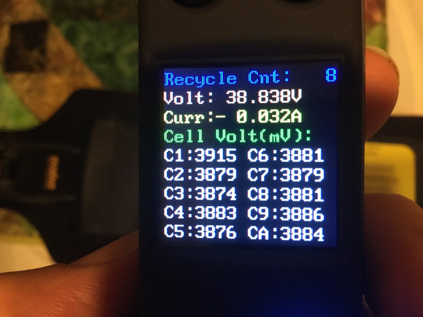

  19. julian46
    julian46 Member
    Well done ! That works thanks
    Mine shows this:

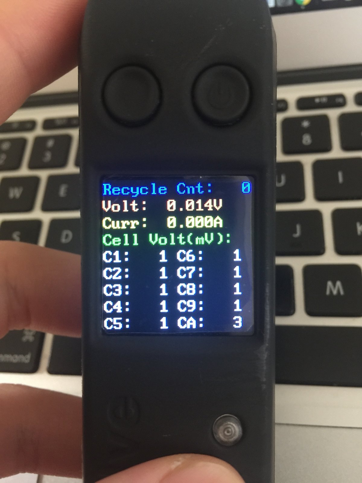

  20. Kelvin
    Kelvin Member
    Glad it worked. I just went to check mine and everything seems to have reset and readings are off, not sure why. I used to have about 60 charge cycle counts and cell voltages similar to yours.
