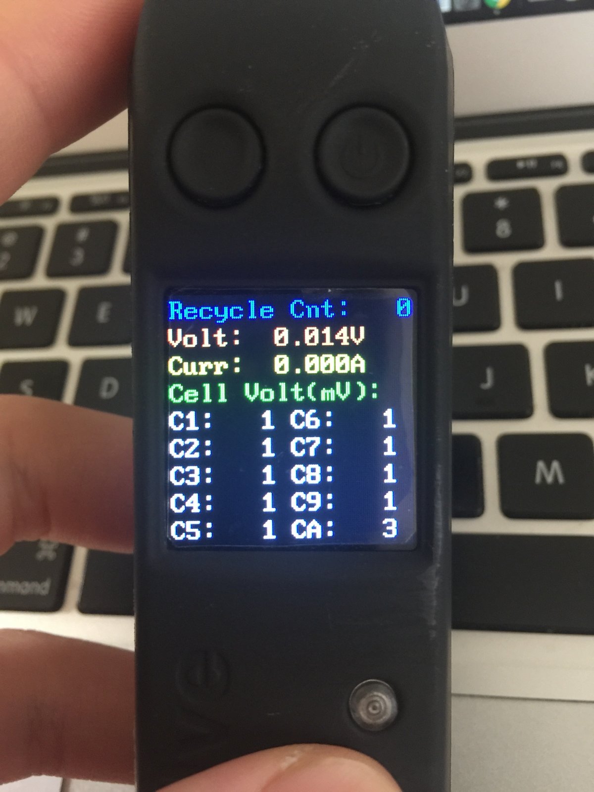

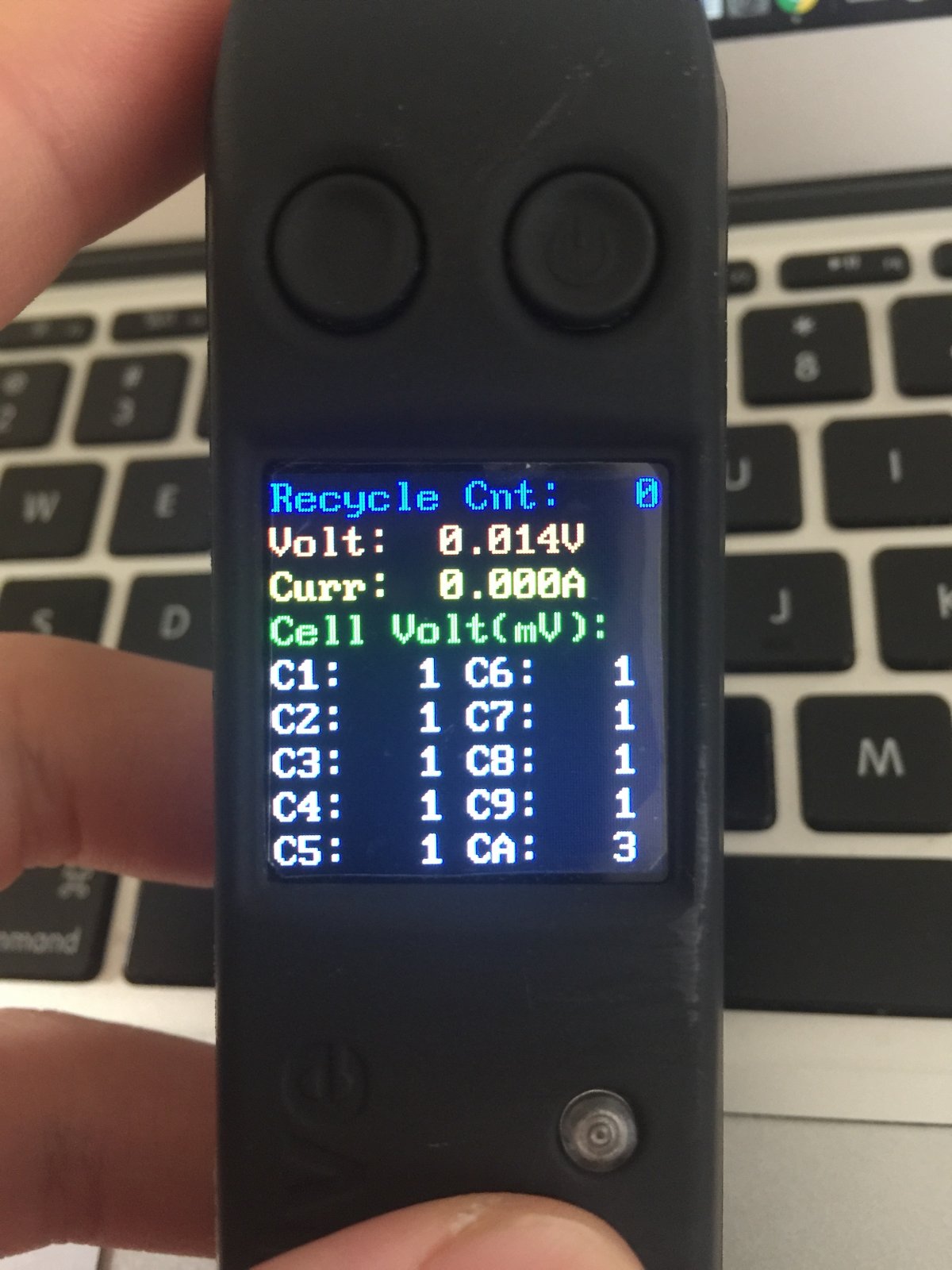

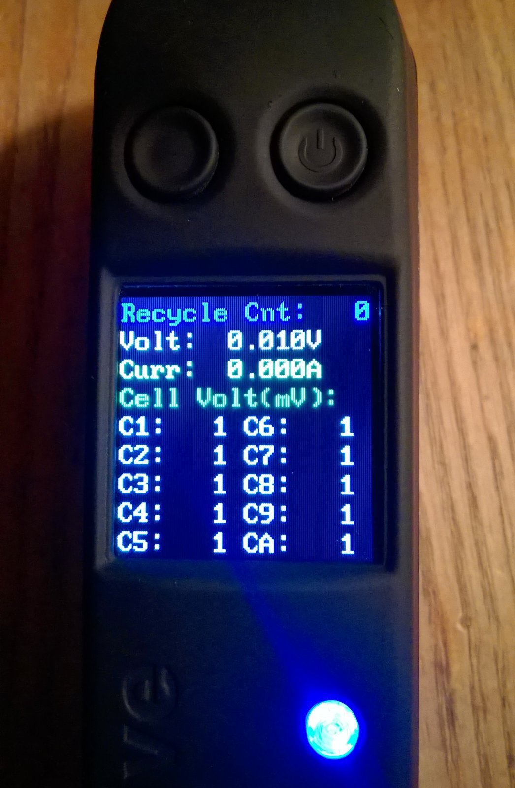

    I have a Bamboo GT. I don't think the battery balances like the Carbon. I've been charging it all week and this is all I have on the hidden battery menu. But it's at 42.1 volts WP_20161208_008.jpg
  2. julian46
    julian46 Member
    I'm pretty sure the Bamboo and Carbon charge and balance the same (the Carbon simply has a bigger pack) - you should be seeing some useful numbers here - not "1"s - mine shows real info - also see your cycle count - should not be 0 - shutdown both and try again - re-pair remote to board if that doesn't work

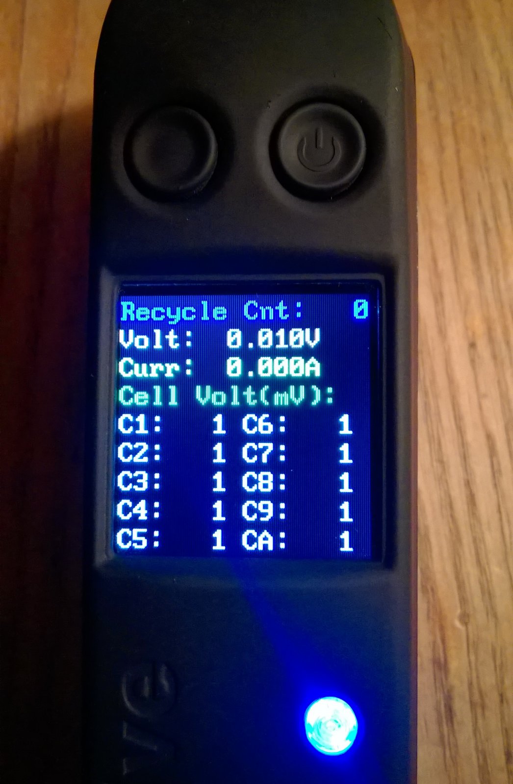

    wiztecy
    wiztecy Member
    That's not a correct reading, some thing or whatever is querying your battery is bad. 0.010v of a battery is a dead battery. And appears you still can ride your board, so its not dead. I think some people have bugs or something isn't setup correctly on their boards.
  4. Kelvin
    Kelvin Member
    I had the exact same problem and tried everything from re-pairing to checking all the connections inside the board. I've seen two other people on the forum with the same issue.
    Evolve said it could be an indication of a faulty BMS, so I sent it back to sort out any issues before my 6 month warranty ends. No news from them yet.

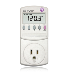

    Anything surrounding faulty BMS needs to be addressed in my opinion immediately for safety concerns. Most importantly that it handles over voltage conditions on the battery cells which can cause a fire if the charger does not shut down after a full charge and the BMS is stupid / malfunction allowing the battery/cell to overcharge over the 4.2V cutoff. This could be just something of no concern, such as the way they're reading from the BMS however its better to be safe then unsure. At least we can read into the BMS to see if its working which is a good thing Evolve did for us.
    I also just found a quick and easy way to see if the BMS keeps voltage on from the charger to balance or if the charger completely shuts down after a charge which we discussed earlier in this thread. There's a product called Kill-A-Watt which measures current and voltage coming out of your wall outlet to the Kill-A-Watt unit and then to your charger or AC accessory. From there we can verify if the charger shuts down the voltage or not after the green light turns on. I left mine at work, so I can't do any measurement plus Evolve has my board and is still running diagnostics on it for the dropout issue. On Monday I'll grab my Kill-A-Watt unit and verify my MetroBoard with the 2 amp slow charger and 4 amp quick charger.

  8. Kelvin
    Kelvin Member
    Got my CGT back after exactly 1 week, which is understandable given they're trying to get orders out by Christmas.
    They replaced the BMS and updated the remote to the new firmware under warranty (free of charge). All I paid was ~$25 shipping to QLD. The battery readings are now accurate and the cycle counts have reset to 0.

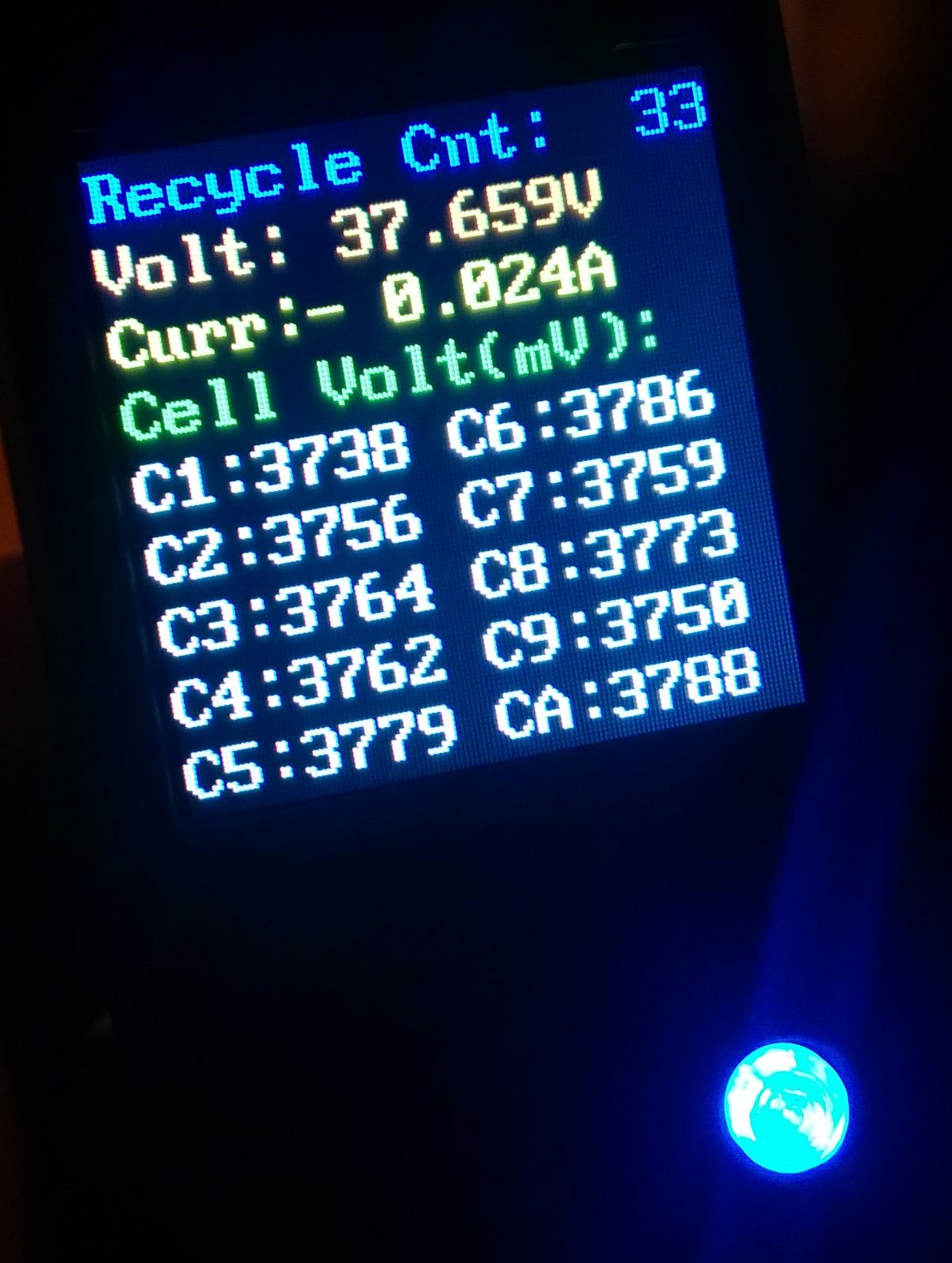

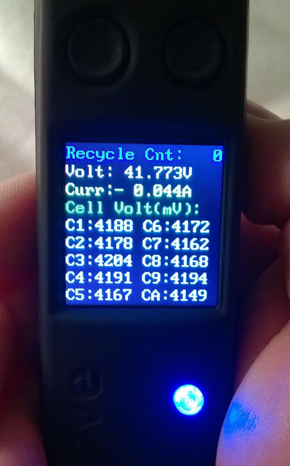

    My Carbon GT shows this. Brand new board, been charging all night WP_20161217_001.jpg
  13. julian46
    julian46 Member
    I think that's normal and if this is your first full charge could explain why cycle count is zero I guess.
    max voltage is about 4.2V per cell
  14. OP
    wiztecy
    wiztecy Member
    Right, and your cells will become closer in the mV spread as you balance more....

    Zac Member
    Update: It turns out my Bamboo GT had a bad BMS. Evolve USA replaced it under warranty. Now I get this info :) WP_20170108_001.jpg
