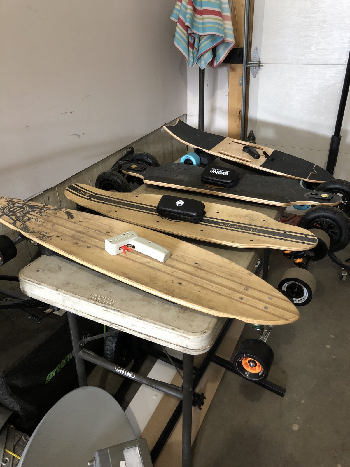

    I usually got around 15 kilometers out of my pintail. Im a heavy heavy guy(300lbs) and I was usually full throttle the whole time.
    I gave the board to my buddy to have a look at. I didnt even check voltage. I now have the Evolve One and Bamboo GTX that I am waiting to ride! Still a lot of snow up here.

    Hall sensor was dirty after a long brake downhill it built up inside the motor. 100% now! Waiting for the snow to melt now!
