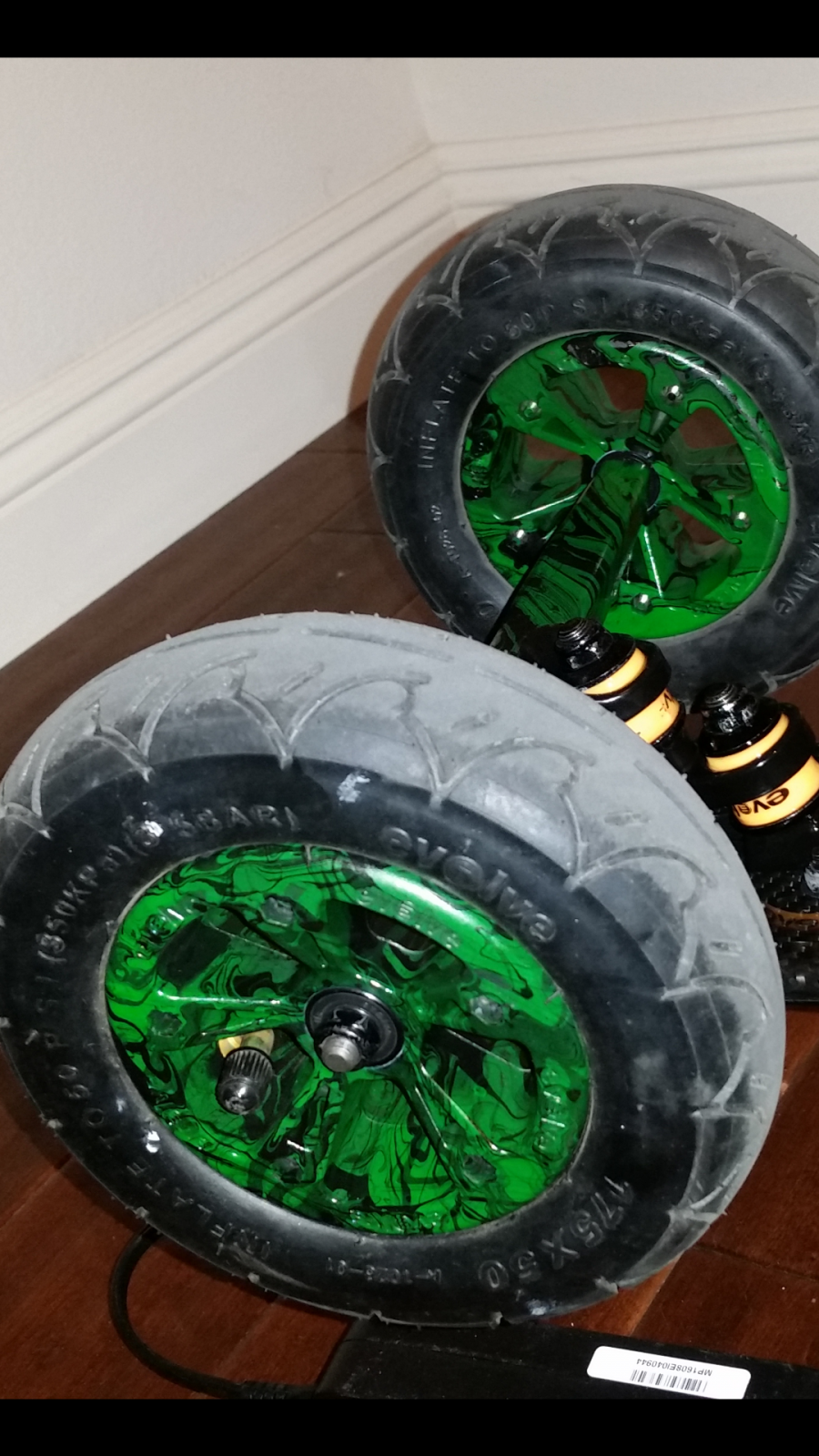

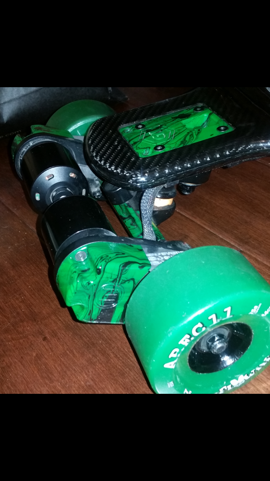

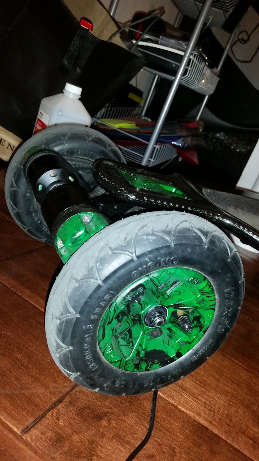

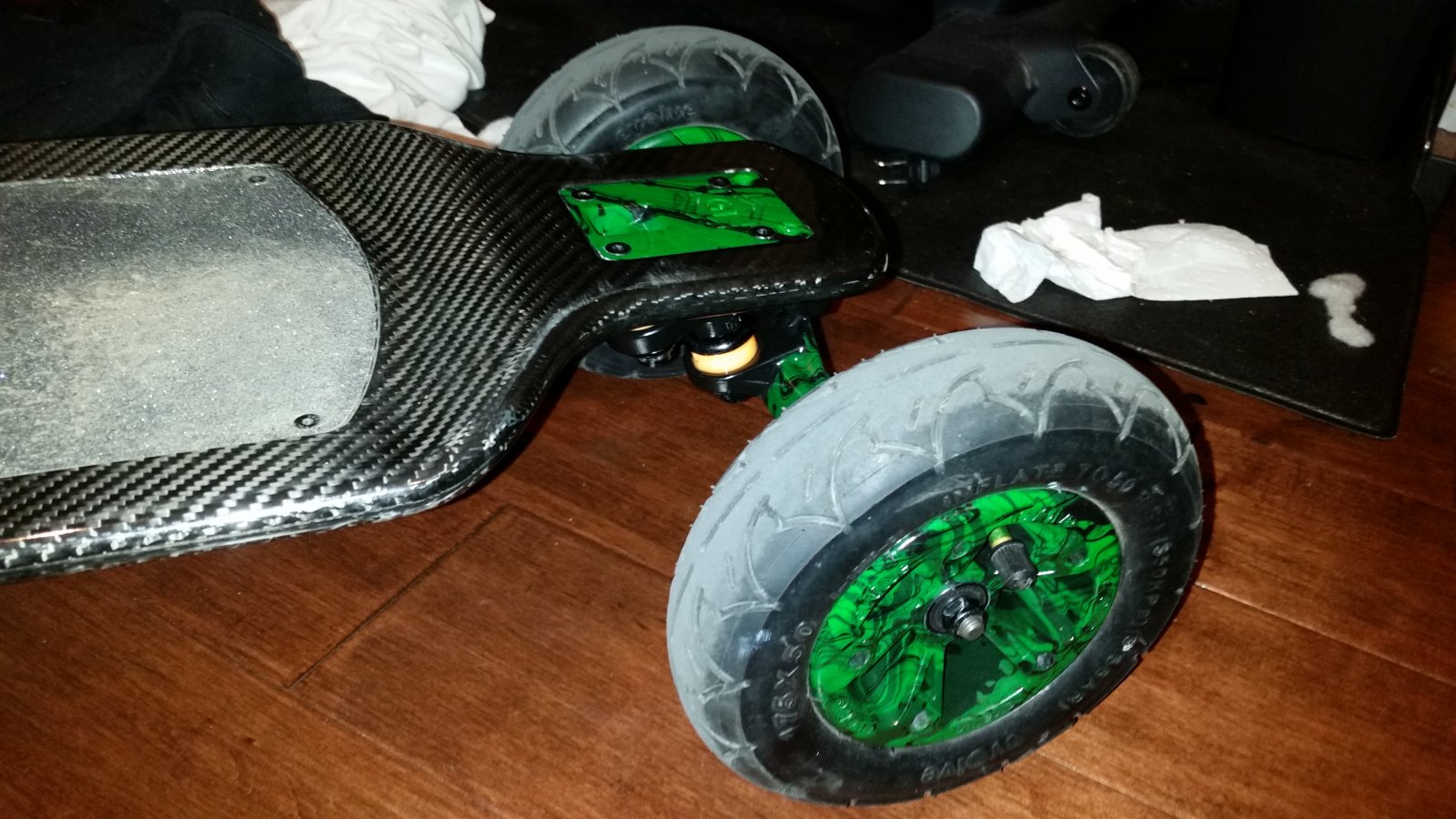

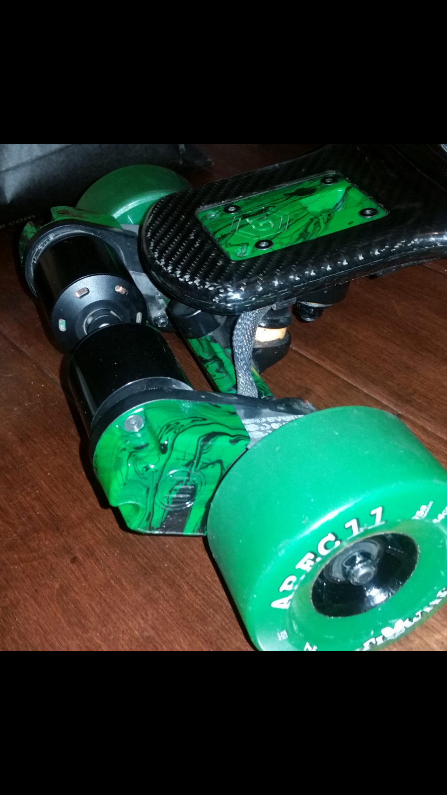

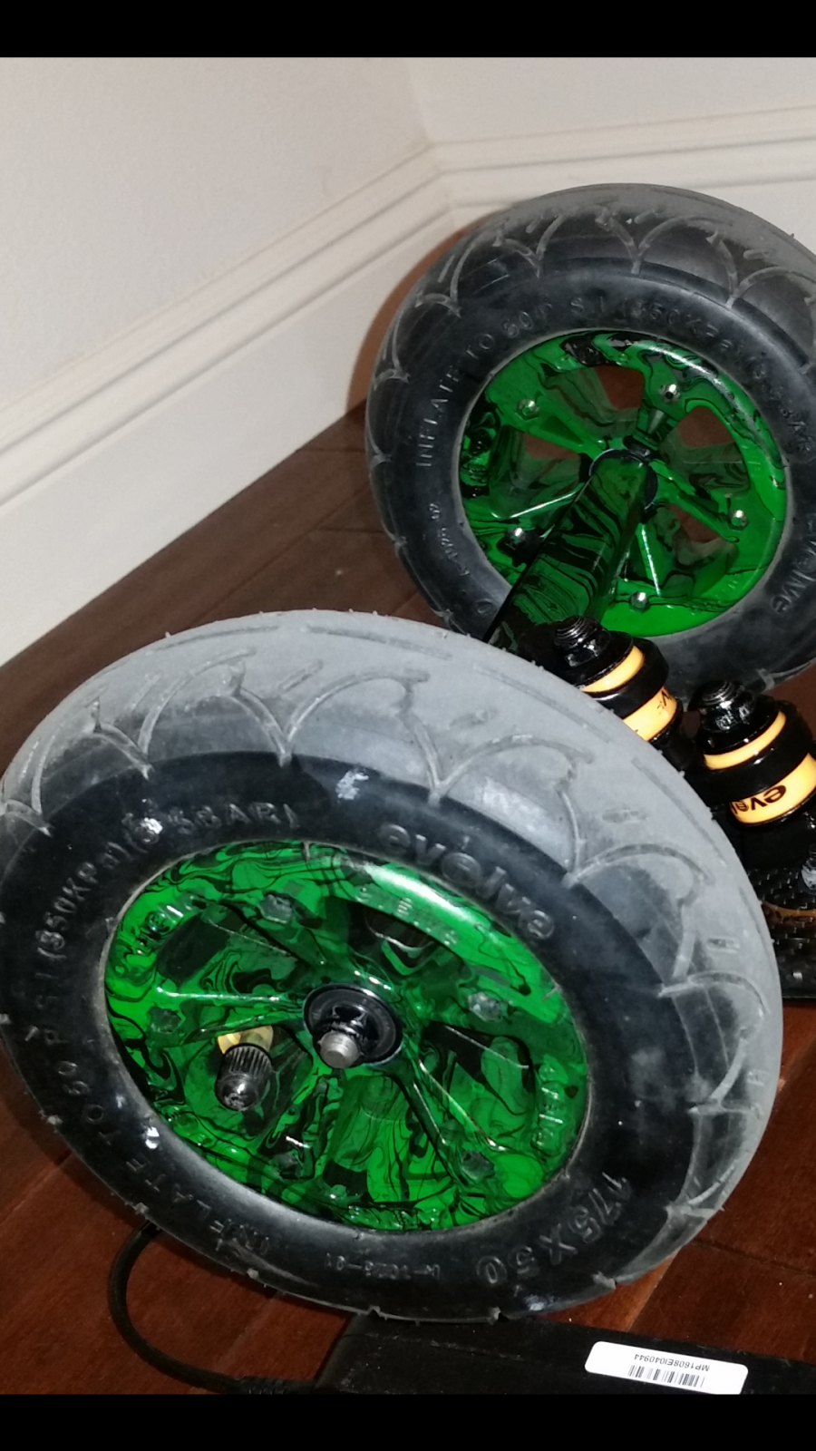

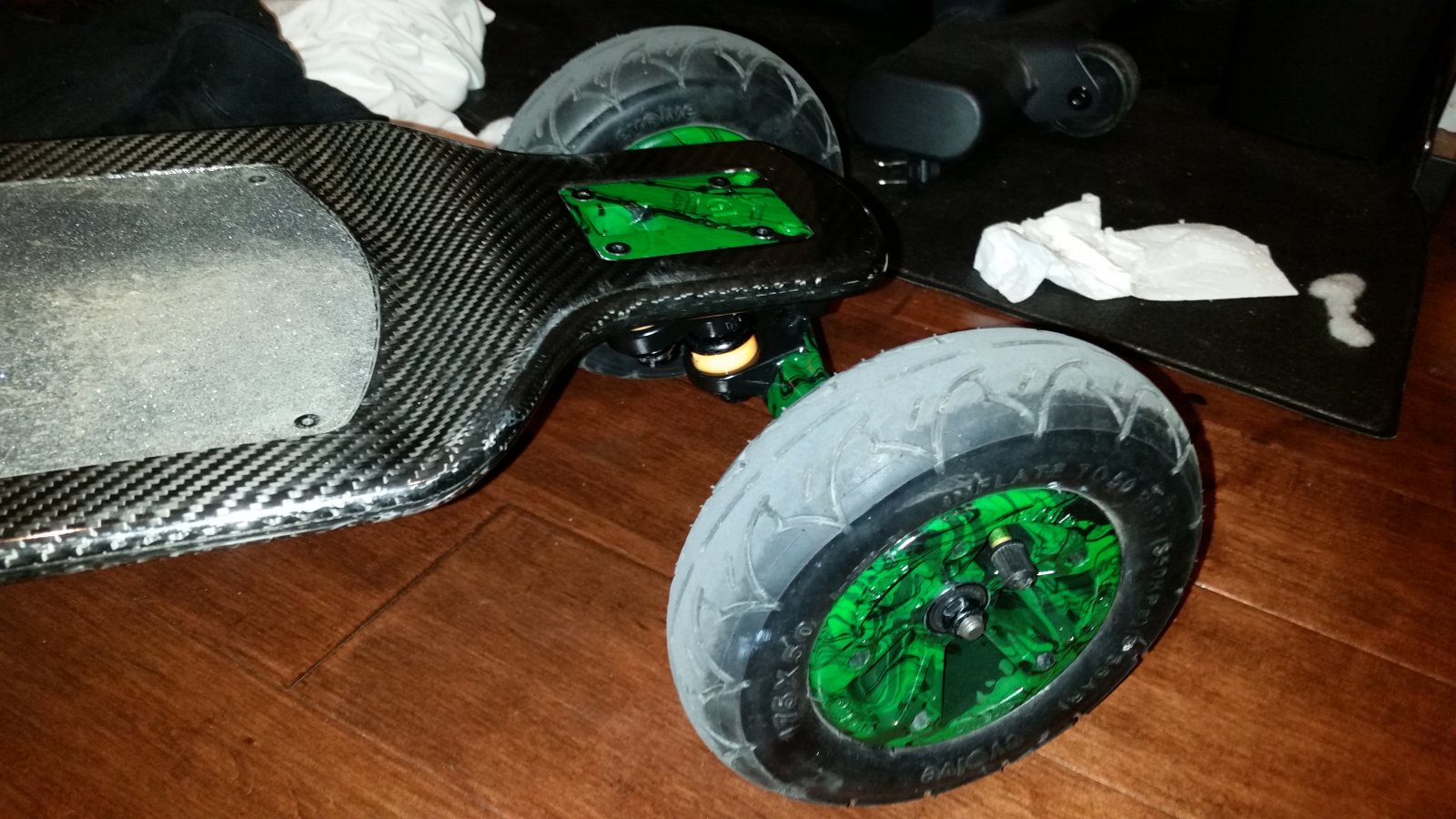

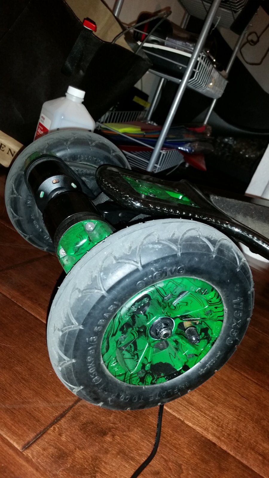

    Followed the swirl paint video.

    I just used spray paint with an adhesive promoter primer.
  7. Monstercmb98
    Monstercmb98 Member
    Thanks. I watched the black/yellow swirl video in the third post down on page one of this thread. I think they use magic marble paint, which is easier to use, but must be ordered online. If you type "borax swirl paint" into Google there will be a bunch of pages on how to do a swirl with other oil based paints and water treated with borax. I used Testors glossy enamel paint.

    DId you just tape off all the wheels?
  10. Monstercmb98
    Monstercmb98 Member
    Yes exactly. Even if paint gets on the wheel itself it will scratch off very easily. Paint isn't made to adhere to soft urethane.

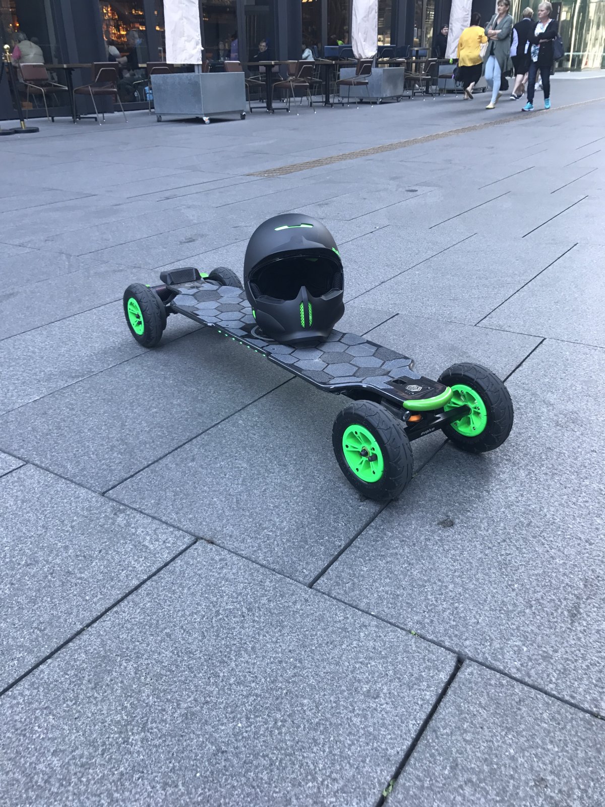

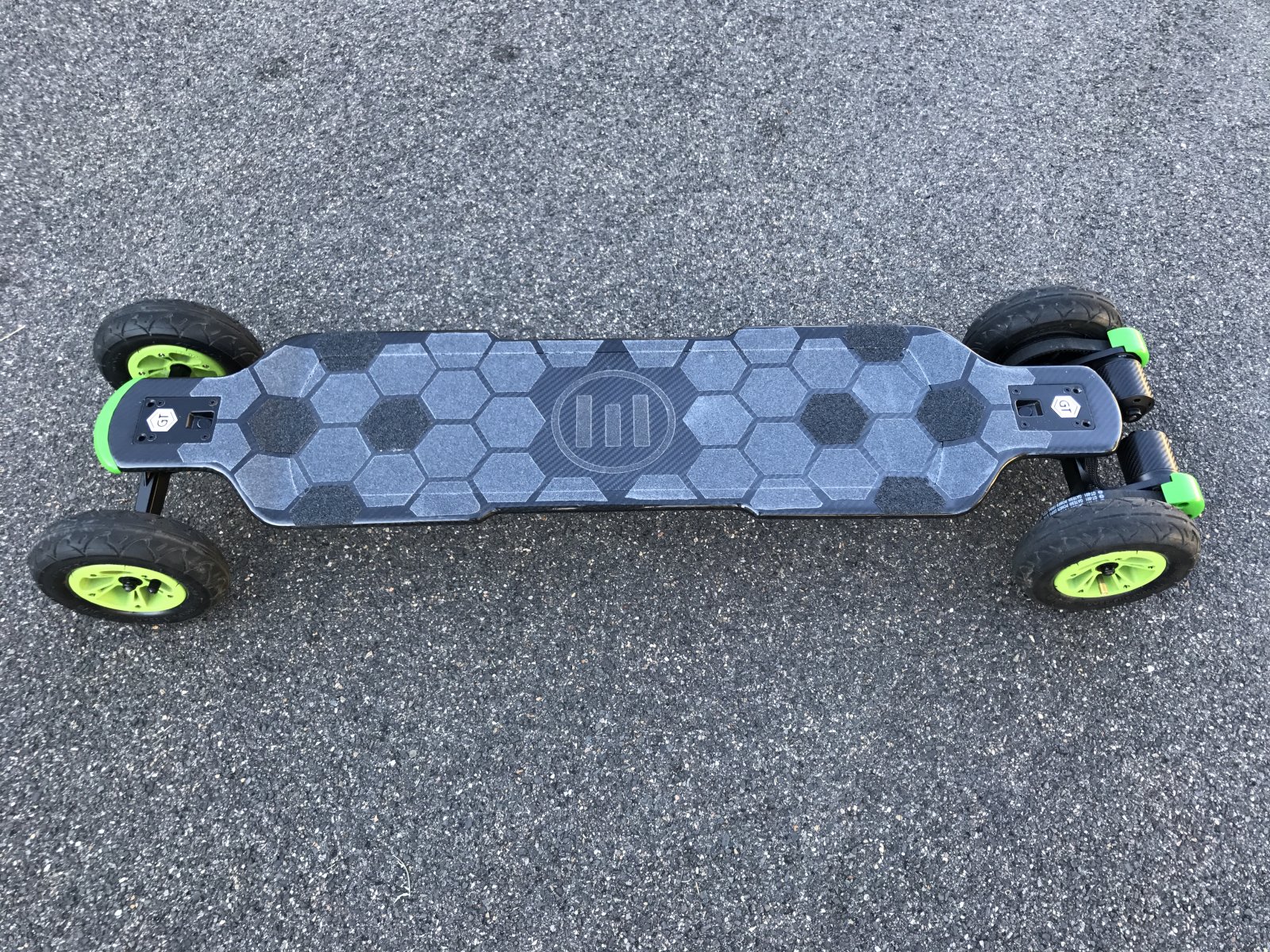

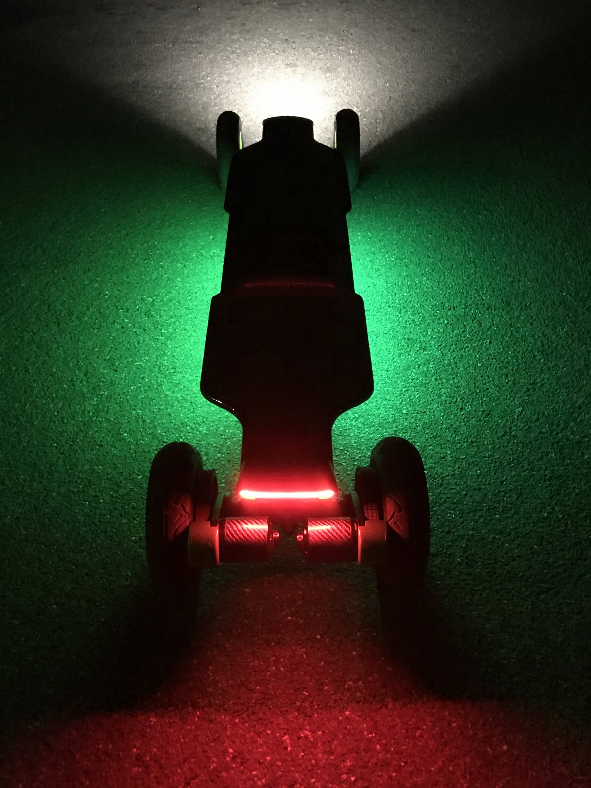

    I wanted to personalise my board a bit, so I hand cut and applied the griptape (Jessup and Vicious) using a design I borrowed from a nice gentleman in Switzerland (thanks Carpi), did some work on the wheels (peelable paint), and bumpers from Bumper Board Shop. Lights are inbound from Shredlights, and "hover board" LED's are ready to be installed under the deck. That should do for now...

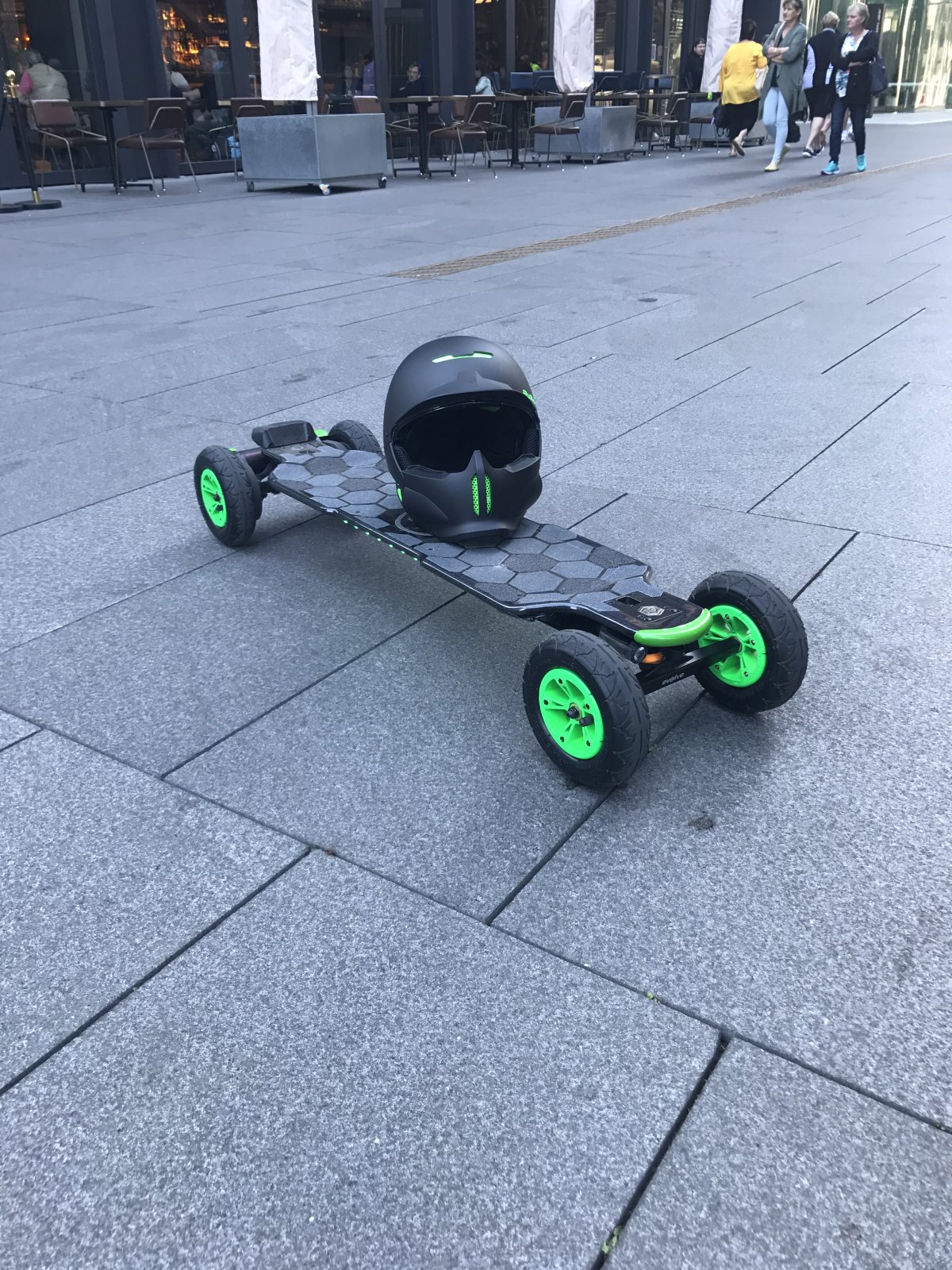

    I just bought some 4D carbon vinyl wrap on eBay. Was simple to put on, and trimmed the sides carefully with a razor blade to make it fit perfectly.
  13. CapeTownGuy
    CapeTownGuy Member
    Thank you! Your Carbon looks awesome! Love the green and black! Really makes the board pop!

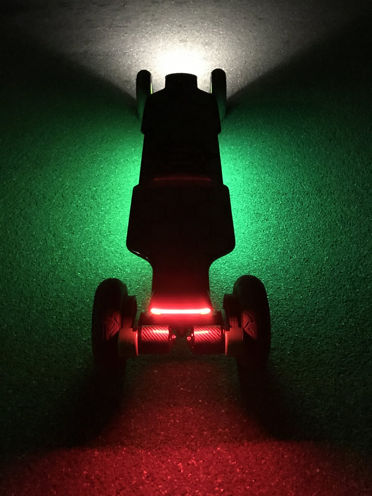

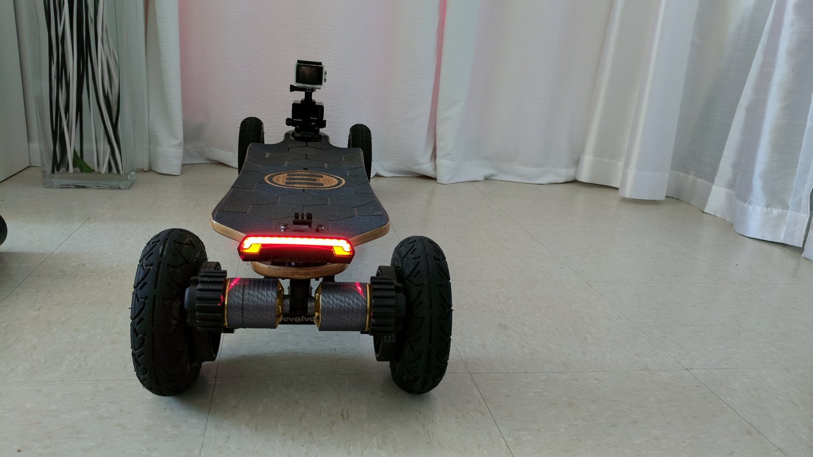

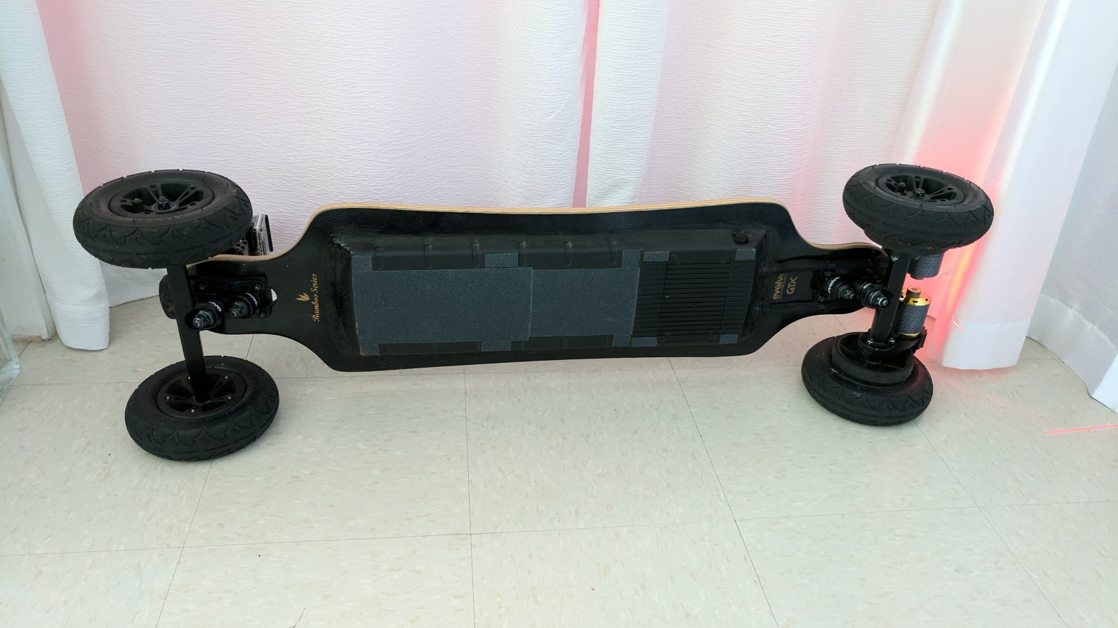

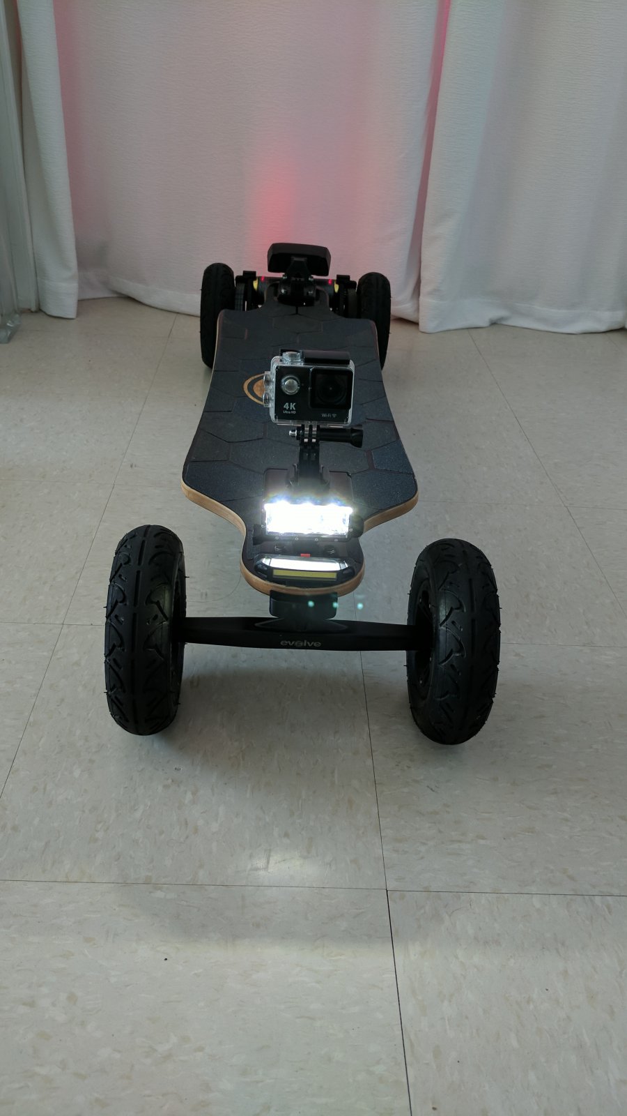

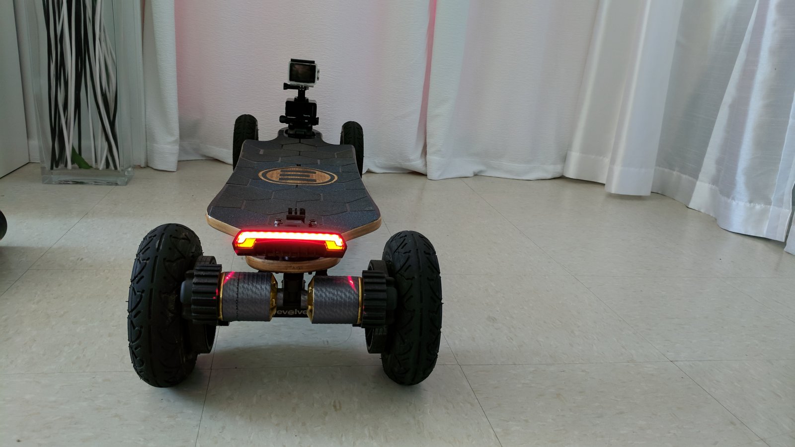

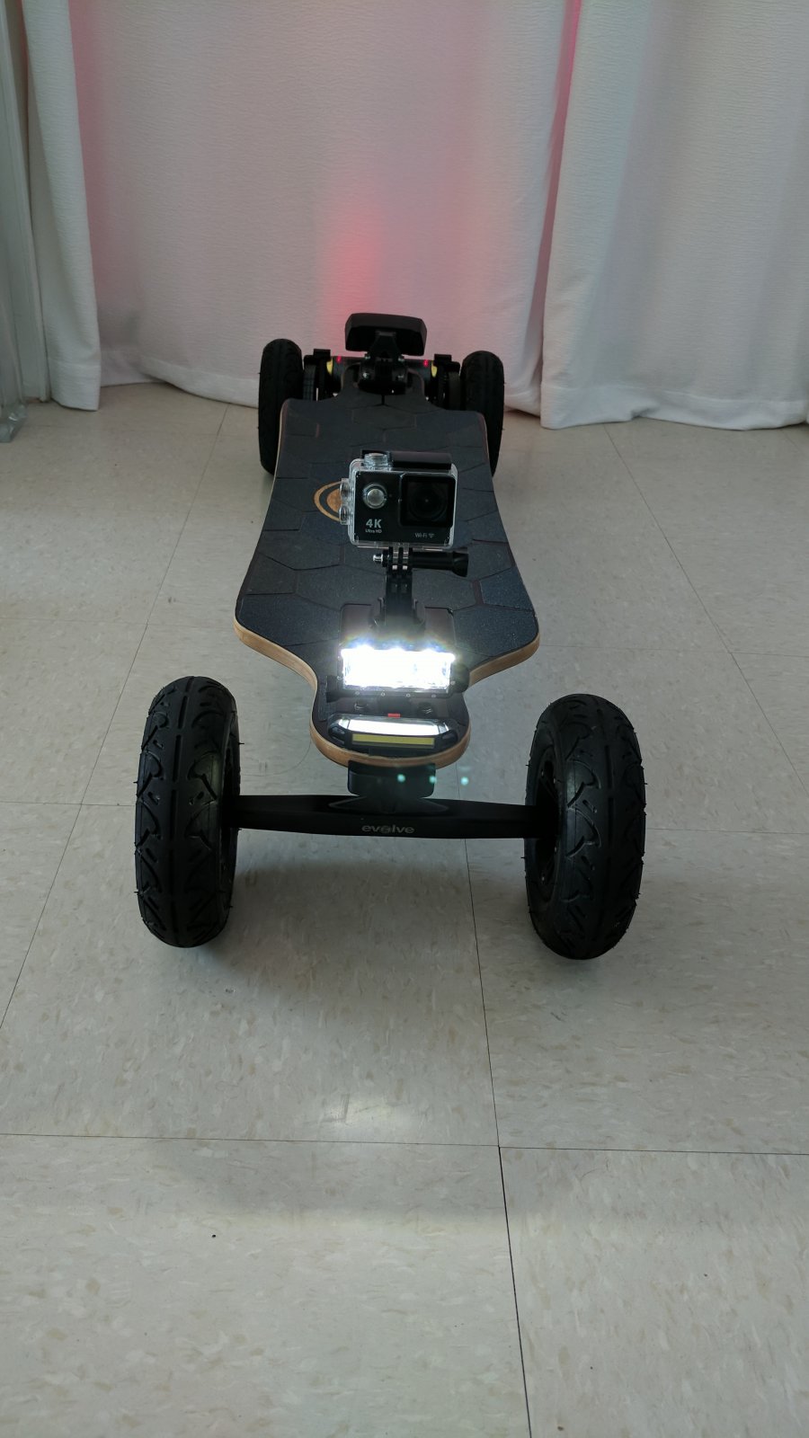

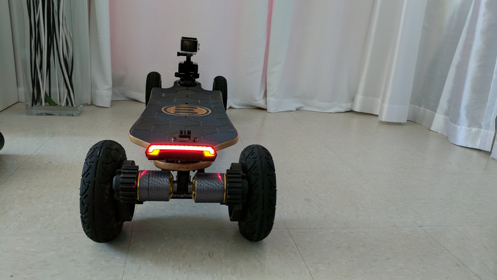

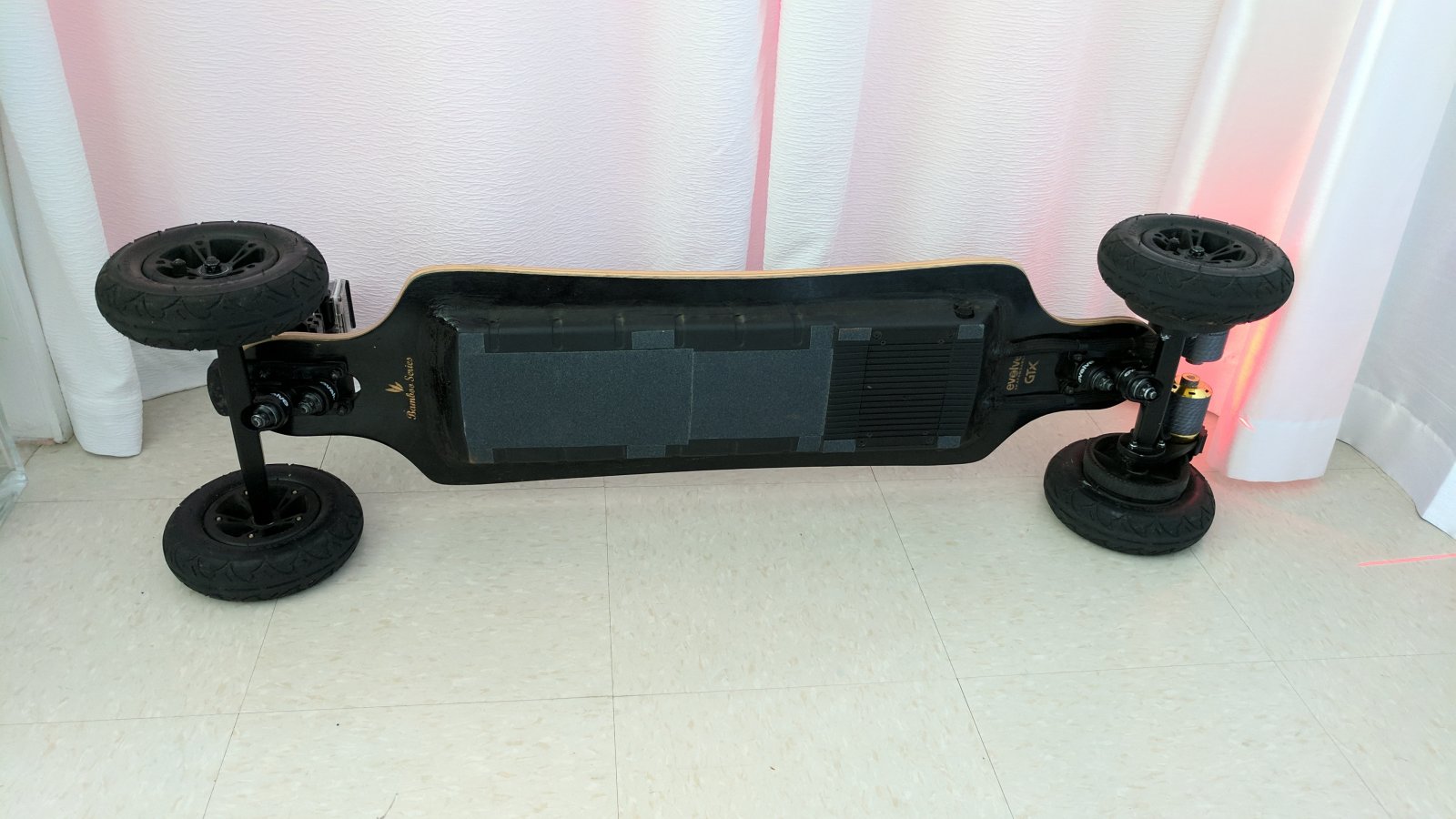

    3D prints, Tail, and Headlamp for night time riding, Undercarriage grip tape.
  17. Ghost1111
    Ghost1111 Member
    what are those headlamps/tails?
  18. ulangreg
    ulangreg Member
    in description
  19. TheyCallMeG
    TheyCallMeG Member
  20. ulangreg
    ulangreg Member
    How did you attach your taillight?
