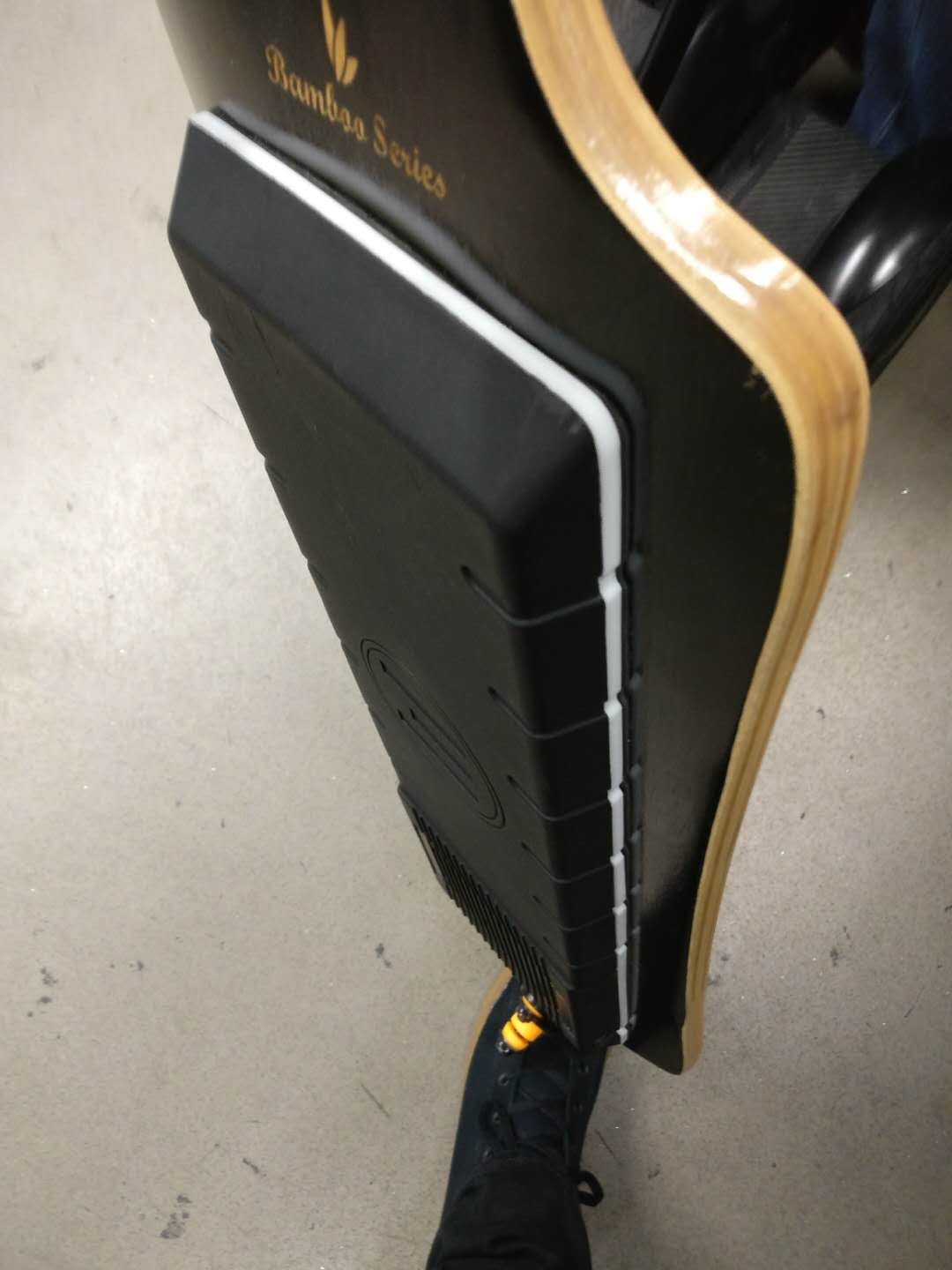

    Hey dude, are you willing to share your design ?
    I just made the battery upgrade and unfortunately i can't have access to any CNC around here.
    But i have a 3D printer !
  2. Murray
    Murray Member
    Looks great! With an accurate design and good quality filament it's a damn good option.

  11. KWasch
    KWasch Member
    I just finished a 18650 battery swap. I found a 3d printed spacer on Thingyverse. Cost me like $20 to have made. Fit was a little off but easily fixed. I’d like the files for the spacer a few pages back. That looks like a better fit than mine @UrNzWy
  12. Vishnu
    Vishnu Member
    Can a 10s 3p fit without modifying
  13. KWasch
    KWasch Member
    It would fit within the factory deck cutout but I believe the 18650 is a little taller so deck flex may be a concern

  14. walterafable
    walterafable Member
    Yes, the CGT battery, BMS, and motor controller will fit in one of the Bamboo decks. The safer bet is the GTX deck as it has slightly more room that the GT due to the portion that is routed out of the bottom side of the deck. Don't forget to buy the enclosure.
  15. walterafable
    walterafable Member
    Nope. When you do this mod, you need to stack the BMS on top of the motor controller. Without the spacer or additional space routed out from under the deck, it won't fit. The 18650 cells also benefit from the additional space since the board flexes The gained space gives the pack some safe room to move around, limiting the potential to break one of the battery welds, causing a short and a fiery death (to your board). The spacer is really the best way to go. There is another design posted on Thingiverse that has 4 parts. That's the one I used.

  18. Paul
    Paul Member
    I’m just starting a similar project for my wife’s a Bamboo GT. Here in Brisbane Australia we’ve an active FB group. When I raised the issue of space there I got this reply:
    This spacer from Murray Owen is a cracker too if you have a 3d printer with a big enough bed (it needs 300mm x 300mm). Gives enough room to use the standard box with a 10p4s array.
    8mm Spacer for Evolve Bamboo GT GTX (2-piece) found on #Thingiverse 8mm Spacer for Evolve Bamboo GT GTX (2-piece) by mkowen
    Hope it helps!
