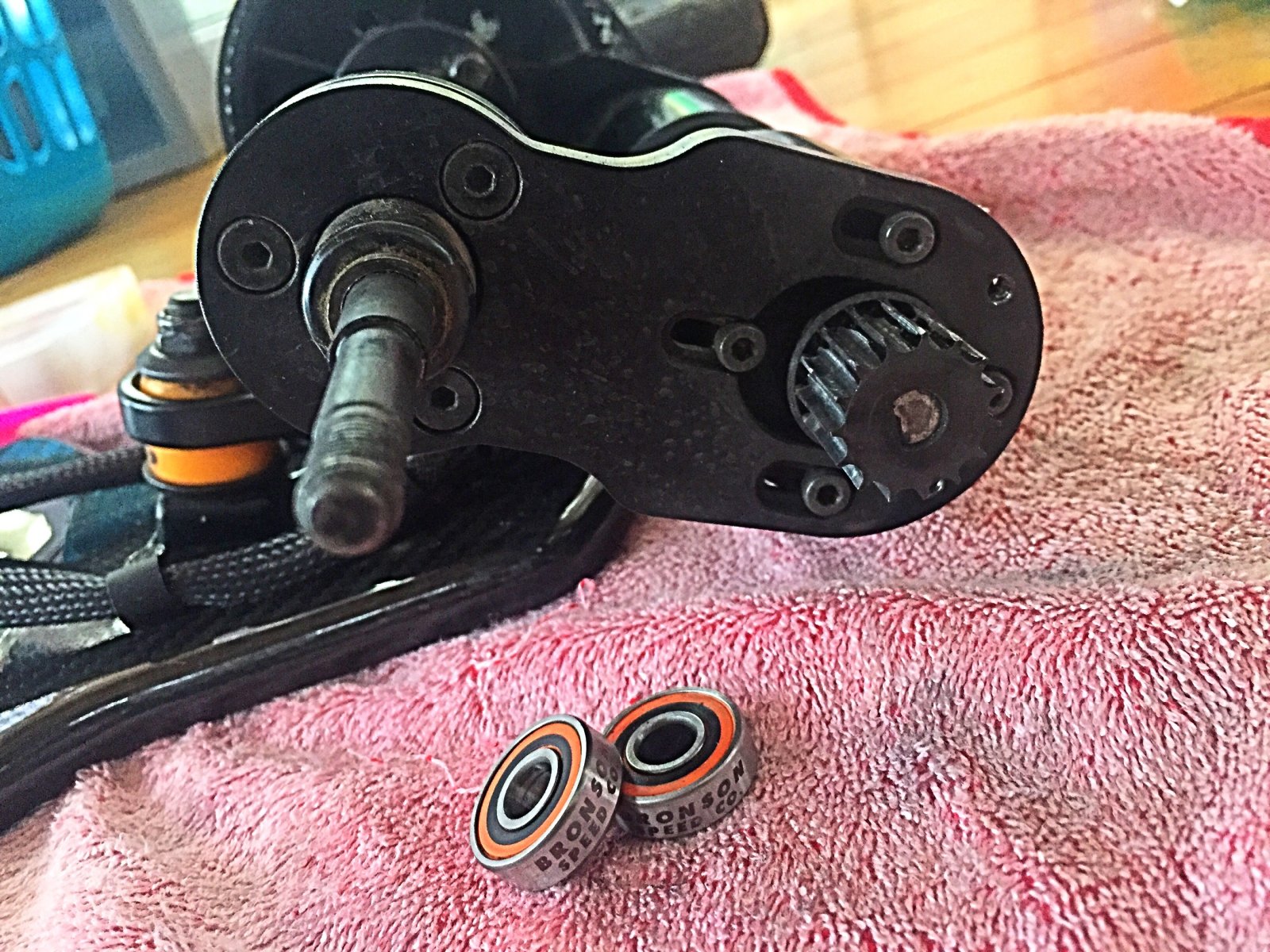

    ;p bit of routine maintenance today as it's wet out and I found 2 loose motor nuts. One was pretty loose and I could of been in for a nasty fall if I hadn't found. Look after your mistress :kissing_heart::punch::punch::thumbsup::beers:

    Do you recommend using Loctite red or similar after replacing a motor?
    Andy
    Andy Mod
    Loctite blue or low strength cos you need to undo again at some point. :thumbsup:
