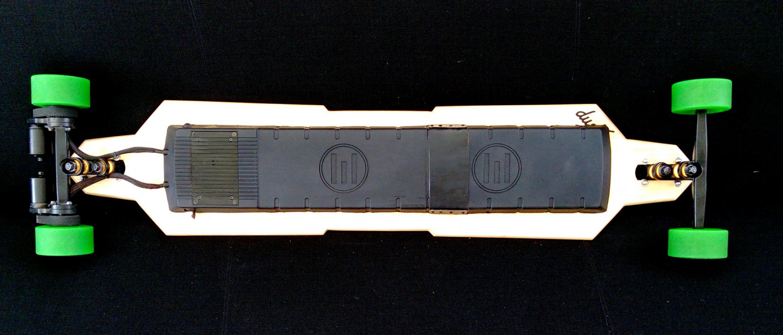

    Hi Guys,
    Does anyone know what is name/make/model of a balance 11pin plug which Evolve GT uses on their battery?
    It's smaller than JST plug.
    Any info will be much appreciated!

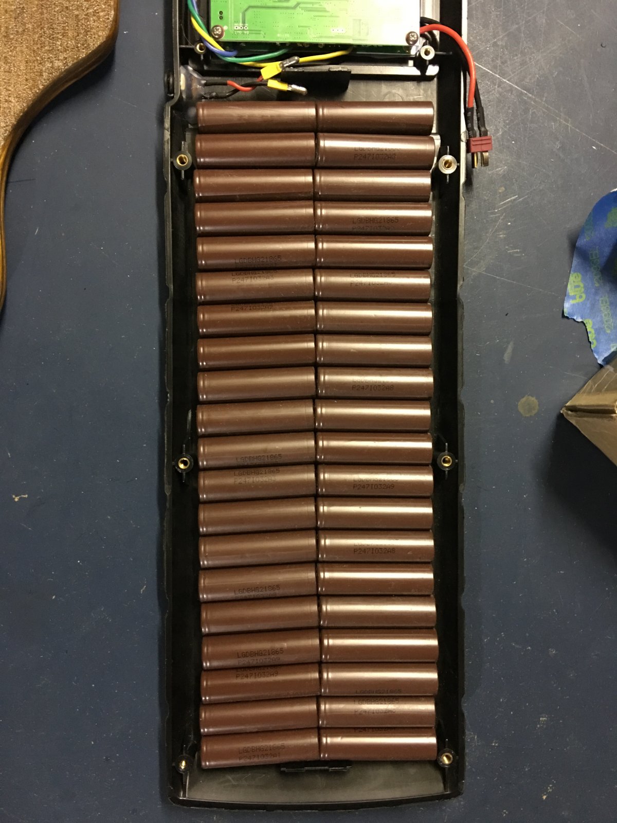

  8. paulfulwood
    paulfulwood Member

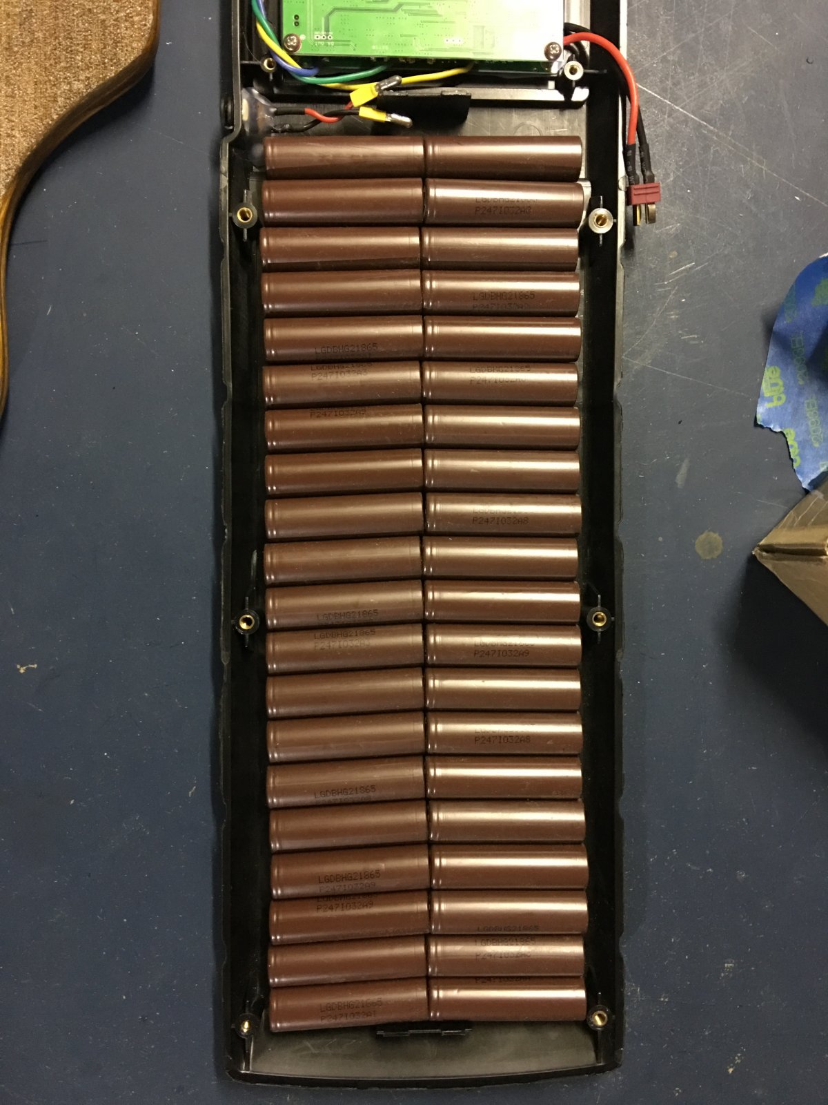

    I can get 50kms with 8 inch AT and and I used 2600mah cells. Seems like a lot of work that is fraught with problems. Admittedly I wasnt smashing the trigger the whole 50kms but I wasnt range testing either. Took me about 2 hours
  9. Evgin78
    Evgin78 Member
    That is one long board!
    How many 18650 cells do you have there?
    Thanks
  10. OP
    SkaterBoy58
    SkaterBoy58 Member
    Looks like 2 lots of 10S 3P or 6P in total?
    Cheers
  11. Nickelberry
    Nickelberry Member
    Pretty sure it's a 10s 6p
  12. paulfulwood
    paulfulwood Member
    60

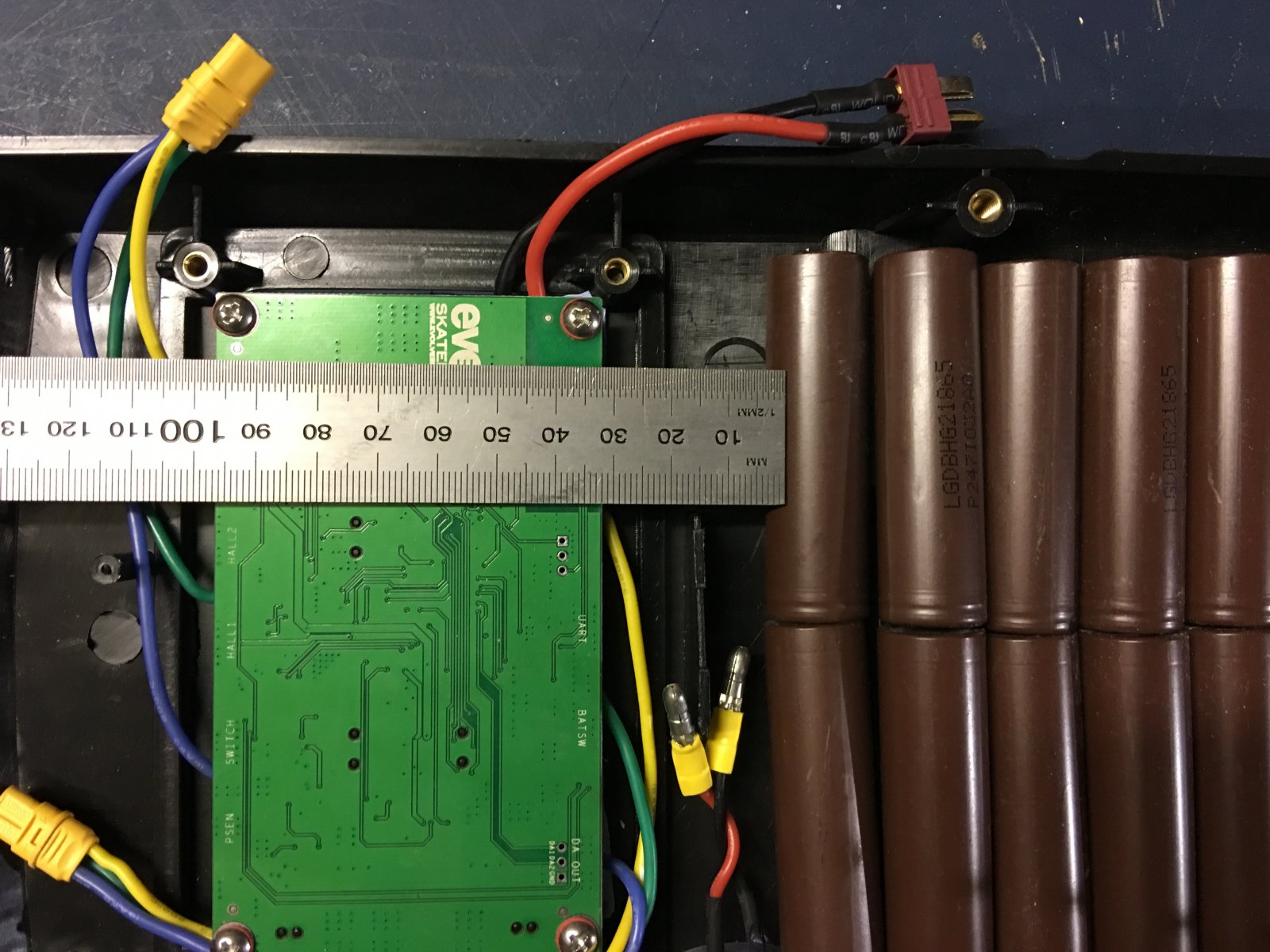

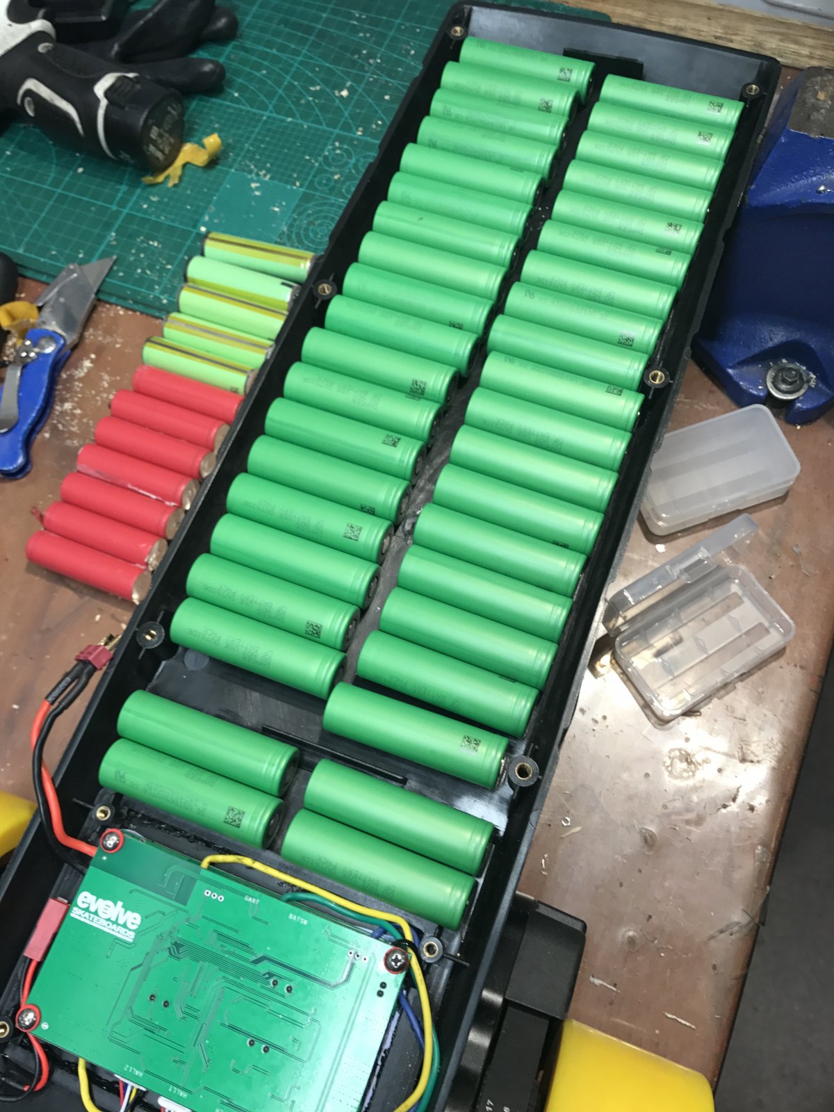

  16. Evgin78
    Evgin78 Member

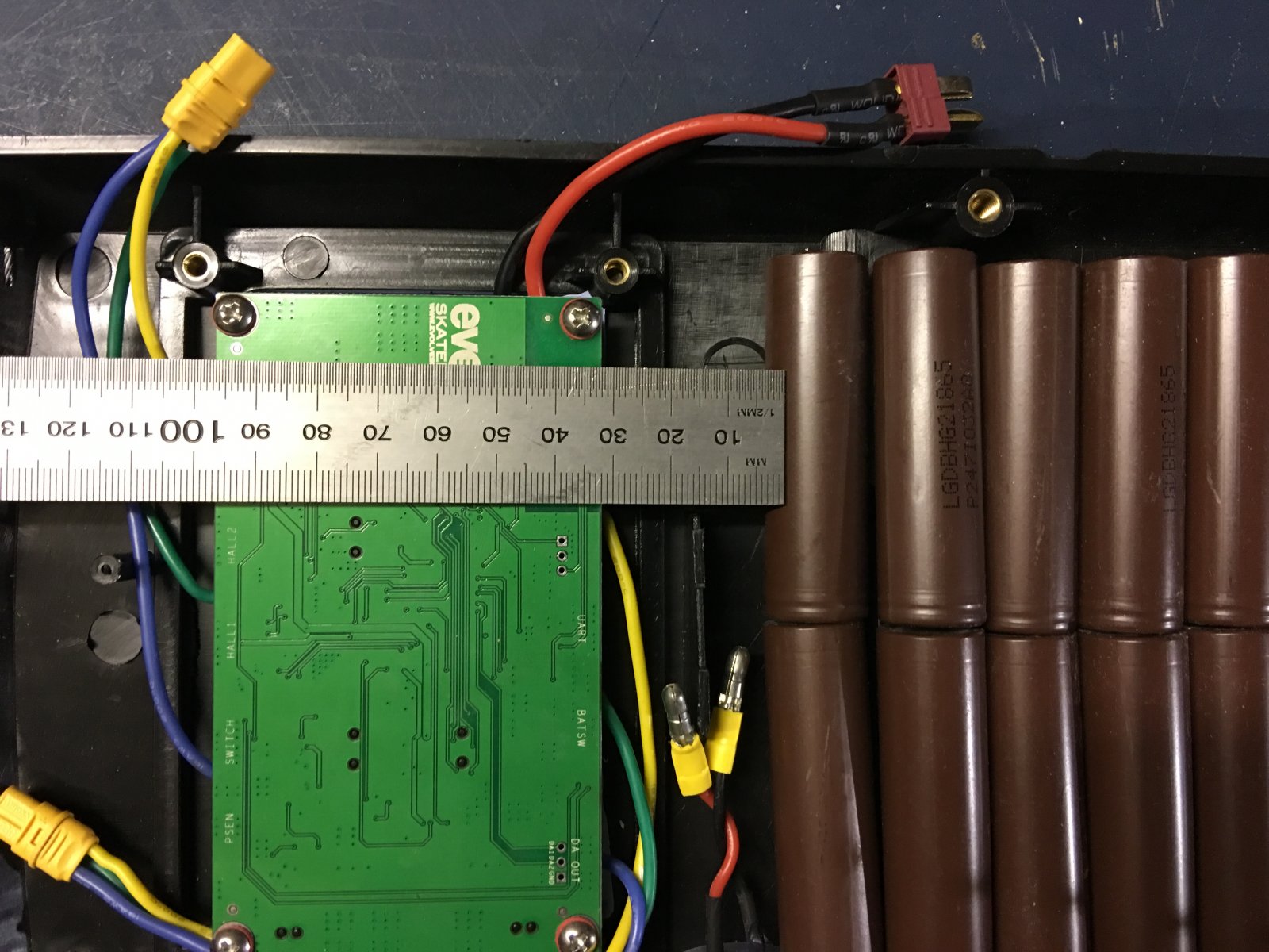

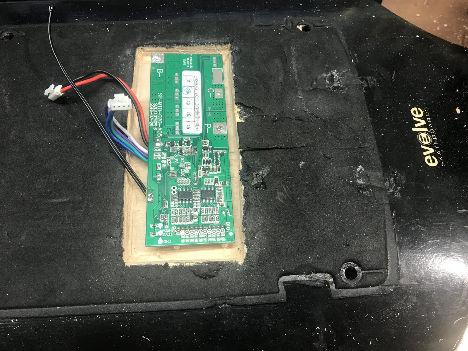

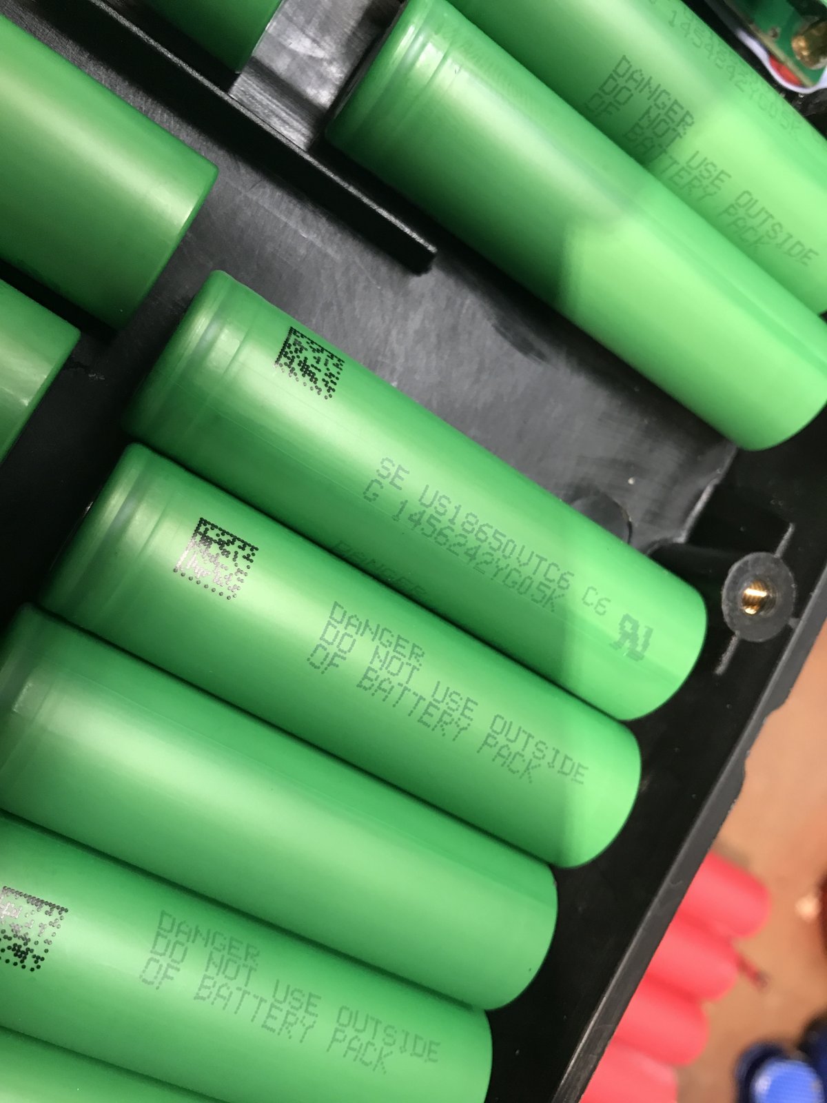

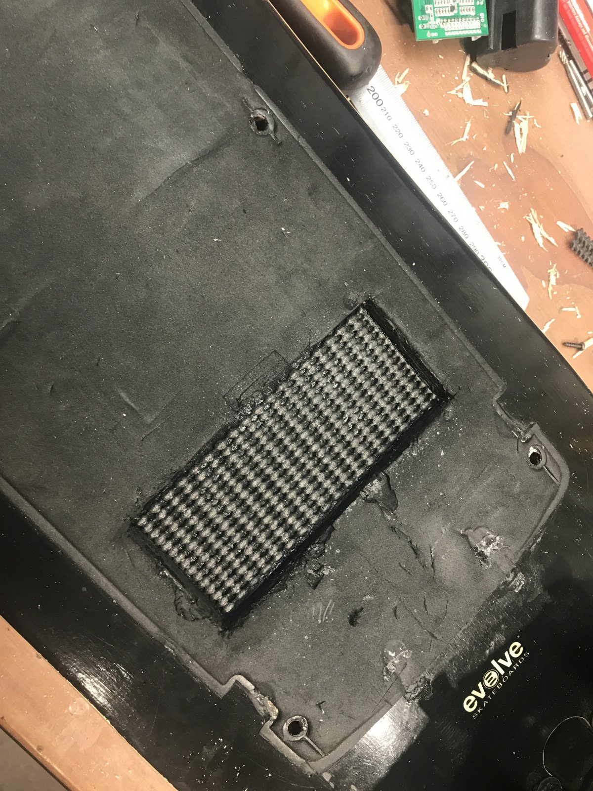

    Quick update. I've managed to fit 10s4p in stock enclosure by moving bms above the control board. Obviously i had to route the deck for it. As it may potentially create a weak point I'll reinforce the area around it with metal strips. Or just make a metal gasket around the base of the enclosure.
    Even now without it I've tried to bend or jump on the board, it looks like no strength was lost.
    I just like the idea of keeping everything neat.
    Also I've decided to go with sony VTC6 3000mah - according to my research and multiple tests I came across they should give me more of usable capacity. However they set me back $12 x 40 vs $7.5 x 40 for HG2 - huge difference.
    Cheers
    • Like Like x 3

  19. Evgin78
    Evgin78 Member
    Batteries have arrived. Spot welded should be here today or tomorrow but nickel tabs are coming from China. So, looks like I'll start building it in a while
  20. OP
    SkaterBoy58
    SkaterBoy58 Member
    Eugene
    Those cells are a pretty look
    Do you mind letting me know of your Sydney source for these ( PM if you like)
    I didn't think there was enough width in standard case for two cells where the mounting thread bit is . Are you looking at staggering cells to avoid these areas (only two off locations) ?
    I am looking at a new enclosure for cells , BMS and VESC - slightly wider, longer and deeper
    Am now considering doing away with stock battery and replacing with a 10S 6P arrangement (with double deck cell packs) and re-use evolve BMS and VESC
