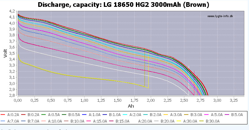

    LG HG2 curve looks much better that other high discharge 18650 cells. I could be wrong - but from what I've noticed from specs - one downside of HG2 is a shorter life : 170-200 cycles. It could be incorrect but these is what I've noticed going through different website trying to compare batteries.

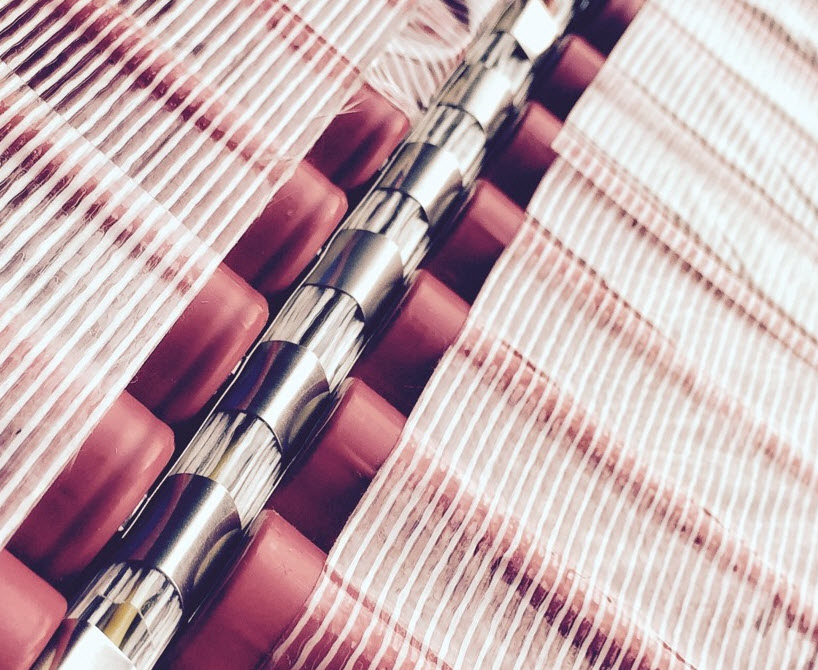

    I only have spacers between packs of 4 not between each cell. Yeah I have seen people use braid I used high strand 10 AWG wire as I could not find any rated braid. Also I dont think you ever want your nickel flexing, it would break over time if it did. You realize if you are connecting each bank of 4 cells to your stock pack you don't actually need to wire your new cells in series, you could just use the series connections in the stock pack.

    I just did a quick search and found this on the LG GH2
    Cycle Life @ 10A: 300 cycles at 10 A
    Cycle Life @ 20A: 200 cycles at 20 A
    18650 Battery Review, Test, Specs 2017: LG HG2 Battery Review 18650 Test 20A 3000mAh Part 1
    So I'm thinking I should be getting around 300 cycles as most of the time I'm pulling under 5 A per battery and never over 17.5 A

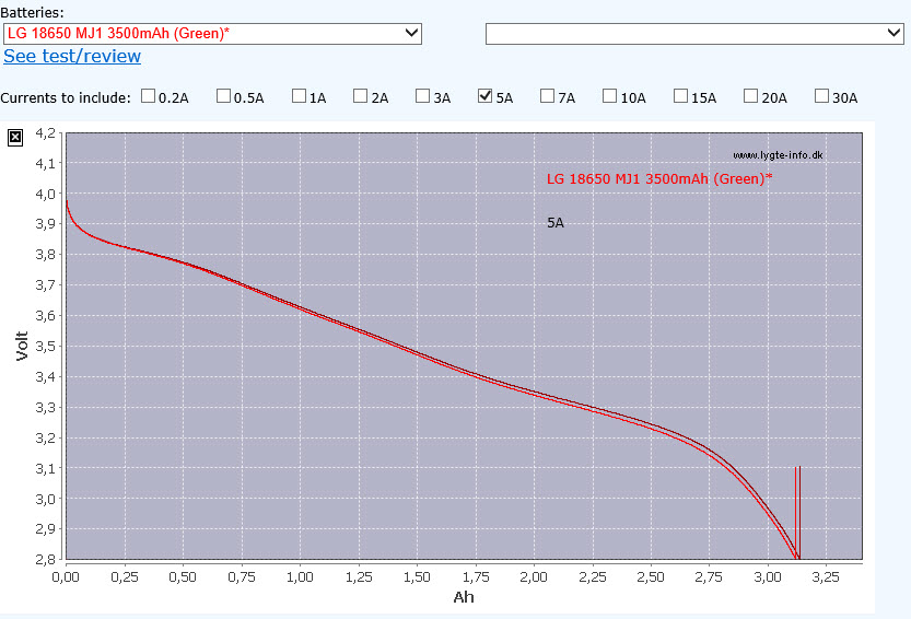

    Sorry - I'm my rush earlier today I quoted the wrong cells I intend to use!
    I am intending using LG MJ1 rated at 3.500 mAh ( ideal discharge scenario of course )
    See link below
    Test of LG 18650 MJ1 3500mAh (Green)
    and revised discharge curve for 5A
    Do you have a voltage % curve for the GT ?

    Makes sense now. Thank you for clarifying that. However I wouldn't go for anything less than 20A. MJ1 rated to 10A.

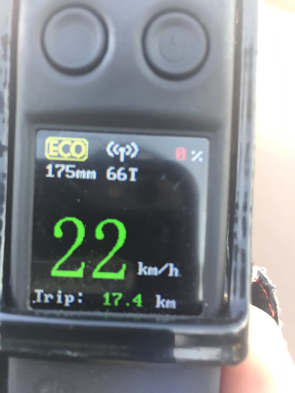

    Did the battery rundown test this afternoon
    Eco mode only below 34.5
    0% on remote =32.5v
    battery drain indicated on remote and battery cut out at 31.5V
    I kept going for about 5 minutes at 23km/hr after remote started to indicate 0%.
    Thinking that cut-out at 31.5 V is a bit conservative and leaving a bit of fuel in the tank but probably cant be changed with stock BMS with uart comms to remote.
    So aux battery capacity can only be utilised down to 31.5V
