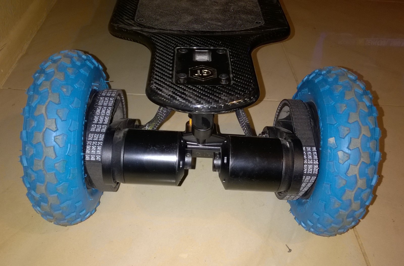

    It haas been good for the past 4 days, muscle memory and finger memory are kicking in and making the rides flawless. also I have the AT wheels on now and they make everything more mellow and amazing!
    street wheels make it a motorised skateboard (what you expect) but the AT wheels make it a vehicle an amazing vehicle
